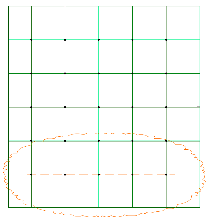

Hi All,
I am using the ceiling pro tool with a 600 grid however the last tile is elongating out larger than 600 (please see attached plan view orange dotted line is where the next ceiling grid tile should begin - also demonstrated by the little hot spots).
Is this a common issue? Can anyone please explain why this is happening and how I can correct it?
Thanks for your time and attention,
Chrissy
AC14 Mac OSX 10.6.8
Chrissy Avramidis
