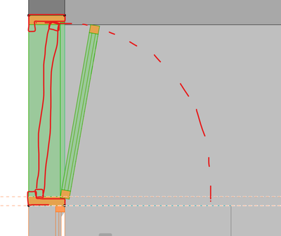

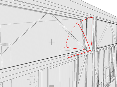

Hello, I'm trying to do a bottom hung window opening to the inside but not in line with the interior wall, how do I change the window depth/thickness to match the images below?

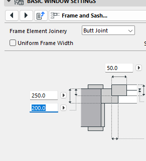

Rebate Depth. Though this does weird things if you want to actually show the window open, as the transformation is applied after the rotation instead of before... This is in the AUS / INT library. Might be fixed in the newer versions. You should include your localisation in your post when asking about things in the library. Even better would be to include said information in your signature.

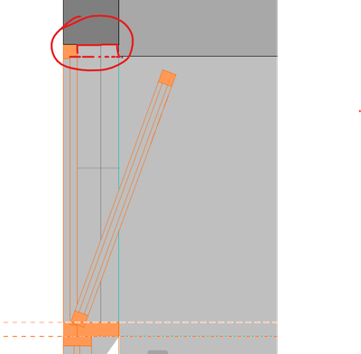

It worked changing the reveal value but now that gave me a gap, how can I solve it?
Im using Archicad 27 3001 POR EDU

Reveal Depth is different from Rebate Depth. One is your window from your wall, the other is your sash to your frame. hence your gap.
