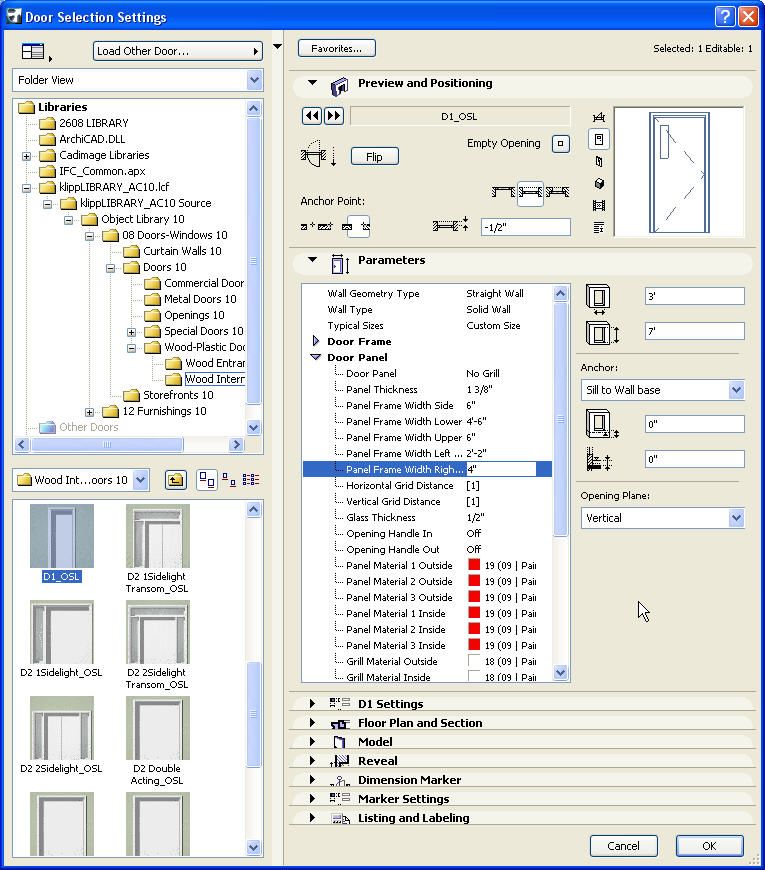

For reasons I still don't understand, my team leader insists that the narrow light windows in fire-rated doors be exactly 4" x 25" -- even though we don't dimension the windows in doors because that's in the specifications.
Anyway...
To make a long story short, I have been lost in macros and parameter names for about 45 minutes and haven't made any discernible progress. Can anyone tell me how to make the Narrow 1 door panel have a 4" x 25" window in it?

Jay -- Not the Narrow Lite 1 panel, but you could use the "No Grill" and change the `Panel Frame Width` parameters to suit your needs.

Couldn't you make a custom door panel that was exactly what you want ?
