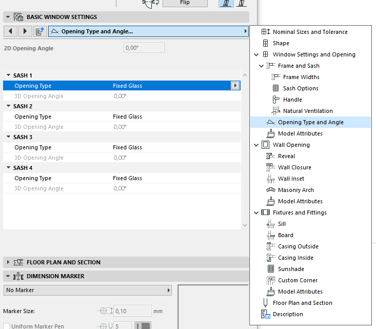

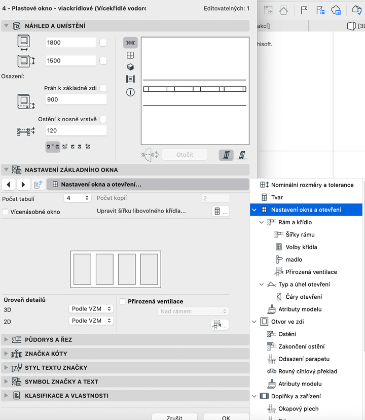

Is there a way to change the opening of a single window in multi-sash window type? Archicad version: 27 CZ

If i get you right, you want to change the opening of every single slash on multi-slash window. On image attached, you select "opening type and angle" and you have for every single sash what kinda opening type you want.
