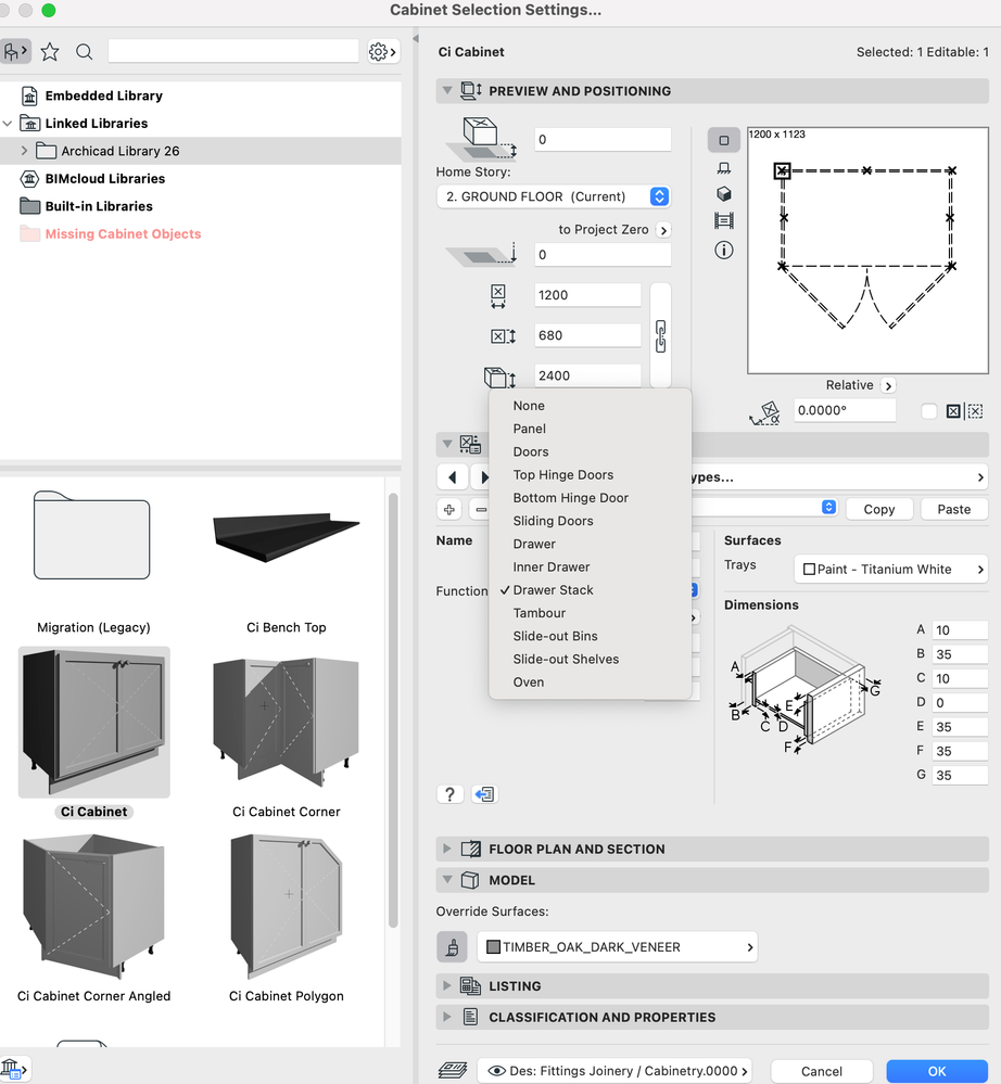

Ci Tools Cabinet : How to create Bi-Fold Doors?
Can not find any help online on how to create Bi-Fold Doors in the new ci tools Cabinet Selection Settings...
Operating system used: Mac Intel-based Sanoma
1 Reply 1
SSK_BIMVIZ
  • Go to CI Cabinet Settings > Modules
  • Select either Door Left or Door Right module, depending on your design requirements
  • Within the selected module, set the Function to Doors
  • Then, choose 2 Leaves to create a bi-fold door configuration
This process should work.
