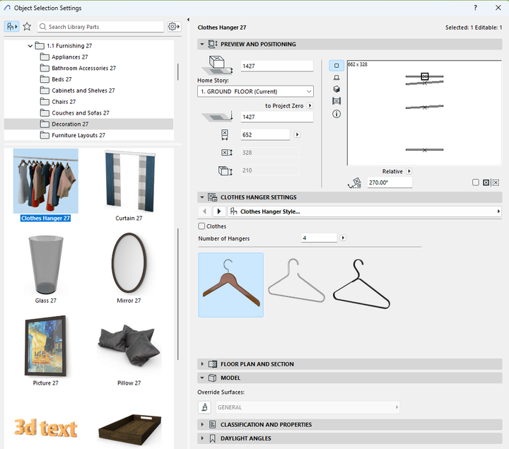

oh my gosh! How did you added the dress there? 😄 I also use CI cabs and was looking for this!

Life saver thank you!!!
