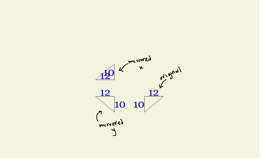

Hello again, I was wondering if you could help me a bit more in my attemt to create this Roof Slope Label. What I'm trying to add in the script (and it's going to affect only the text positioning) is this :
-If the object is mirrored along the y axis then mirror also the text along it's anchor point (I'm not sure if it keeps the anchor point or I should use one of the hotspots that I have)
-If the object is mirrored along the x axis, then do nothing.
Probably sounds a very easy command but I've tried so many different things without any luck...
Thanks!!

It kind of depends how your object is scripted and the parameters you have. A screenshot of the problem and how the object works would help a lot, otherwise is just guessing.
I'm assuming you want readable text? Check if the solution I posted here:
http://archicad-talk.graphisoft.com/viewtopic.php?t=47251
Read the thread and other solutions, and eee if that helps.
Best regards.
Once again thanks for your quick responce!! So, here is the code that I have so far :

I've placed also a screenshot that shows the problem when I mirror the object along the x axis.
The script that controls the rotation of my text I found it on the net and after some tries that I did it seems to work but only for the mirroring along the y axis.

sinceV6
Don't really have time to try it, but I would look into the paragraph and textblock definitions, as textblocks do have an anchor parameter
TEXTBLOCK name, width, anchor, angle........
So that might be the problem when mirroring.
It looks like you saved this from the floor plan as an object, right? It would work OK with the original code, but when trying to make it parametric, you need to review the whole thing.
For simple texts like these, I would ditch the paragraph/textblock/richtext scenario, unless you need the options they provide, and use simple TEXT2 commands.
