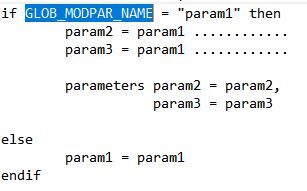

Hi to all,
First I want to thank everyone here, without you I wouldn't have grasped the GLOB_MODPAR_NAME
Second, for the people who will ask theirselves how to apply the same idea for more than 2 parameters, just follow the same block and repeat for every parameter you want to link
