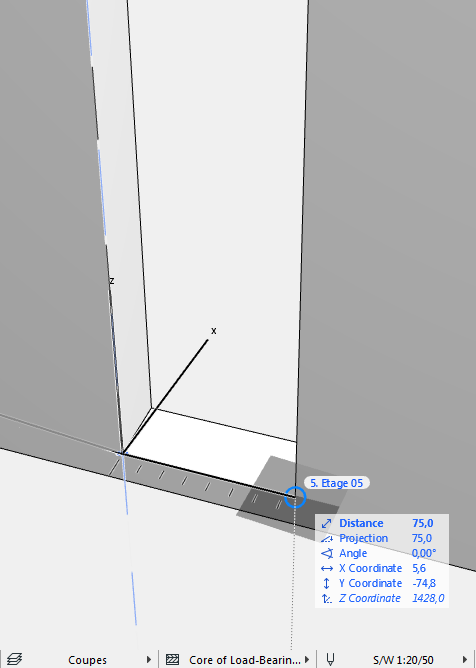

We are using the Core of Load-Bearing option to export our 3d model in IFC format to the static engineers but the openings of the windows do not show their real dimensions if Wall Closure is used.
The skin is correctly turned in plan view but in 3D it's considered as 'Core'. Imagine our surprise when we got back the plans from the engineers and all windows were smaller.
