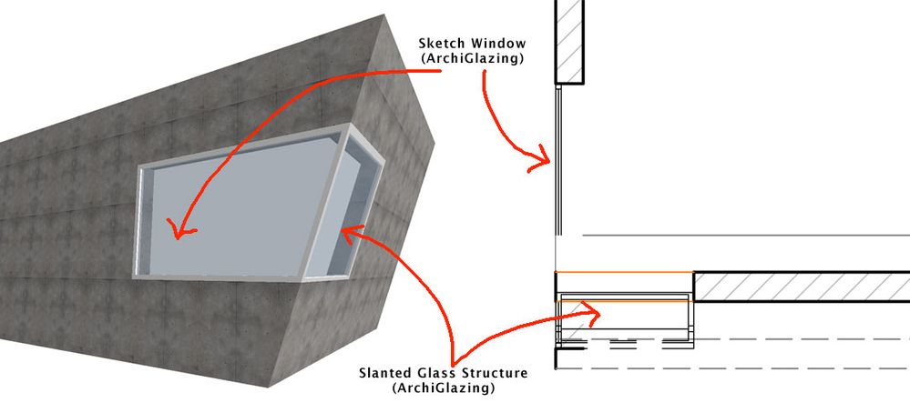

ArchiCAD has a Corner Window tool, however it works only with straight walls. How could I make a corner window, when one of the walls is slanted?
Please look at the attached image. I placed Empty Opening (Opening plane: Vertical) in the slanted wall and then created Slanted Glass Structure with ArchiGlazing. 3D view looks good, however 2D plan view is complicated.
Any idea is higly appreciated.

*BUMP*
...since I'm currently struggling with the same issue.
Am also trying the empty opening, but this results in only one out of two openings.
Help is appreciated

Hi Dalius,
Once your 3d view is ok, I'd use a patch to cover the 2d mess.
HTH.
