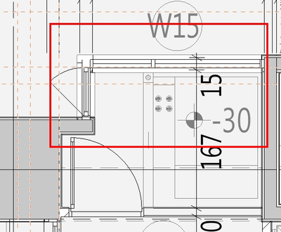

Hi there, I need to place a window that involves two intersecting faces. Currently, I can only position two separate windows without combining them into a single unit. The problem I'm facing is that the intersection doesn't appear accurately in the plan view. Do you have any suggestions on how I could achieve this correctly? Thanks

Doors do not have this issue which has been a long term wish so if you have those situations, you are stuck with a scuffed corner...

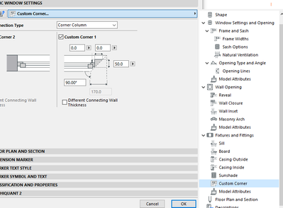

They will never be a single unit.
In the window options you should see a section for corner connections.

Okay, Thanks
