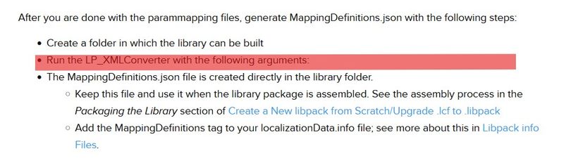

Hej,
Can anyone provide the arguments missing from GS help page : what arguments are needed for LP_XMLConverter in order to create mappingdefinitions.json from parammaping.xml ?

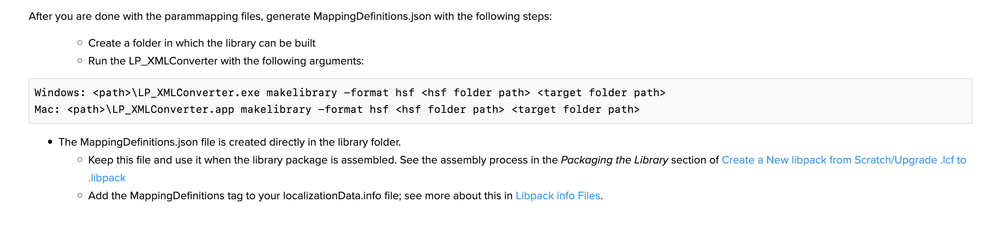

AlexV
Yes, I had opened a ticket with our local reseller and they contacted GS. Got a notification today it’s been solved.
The help page has been updated with the missing command, I’ll close the post

claudiuiancic
Sorry, I misunderstood your question. Please ignore my first answer.
However, here's what the phrase you're referring to looks like to me:

AlexV
