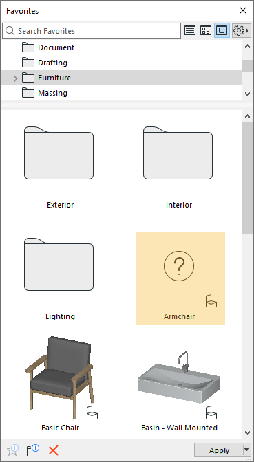

I'm correcting all the Action Center alerts to keep the file clean, but this warning is the only one I haven't been able to fix. I don't need this item since it seems to have been added from a previous project without my knowledge.
I haven't been able to remove "Pocket Door 26" from here or from the Doors window.
Any suggestions?

That is a favourite that can't find the pocket door 26 object because that library (or the migration library) isn't loaded.
If you don't want it, then open the favourites palette, find the favourite and delete it.
This is the icon you need to look for in the Favorites Palette, as it indicates that the Favorite cannot find the necessary Library Part in the project.

If you have a favourite for an object that is not in your loaded library, it will report as "Missing" and will show in the favourites palette with a question mark as Laszlo has shown.
You have 3 choices.
Load the library with the missing object - you may not want to do this if it is an old version library.
Edit the favourite so it uses a library part in your current loaded library.
Delete the favourite if you don't need it.
Actually a fourth, you could extract the old library, find that object and add it to your loaded library.
It may also require you to find some macros.
This is not the best solution.

Maybe you have a Favorite that references that library part.
Find the Favorite, and either redefine it so it points to a different library part, or delete the Favorite if you don't need it.
