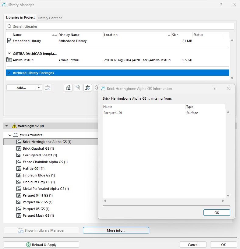

I'm trying to update my template from Archicad 27 to Archicad 29. I've resolved most issues, but I'm still having trouble with some textures.

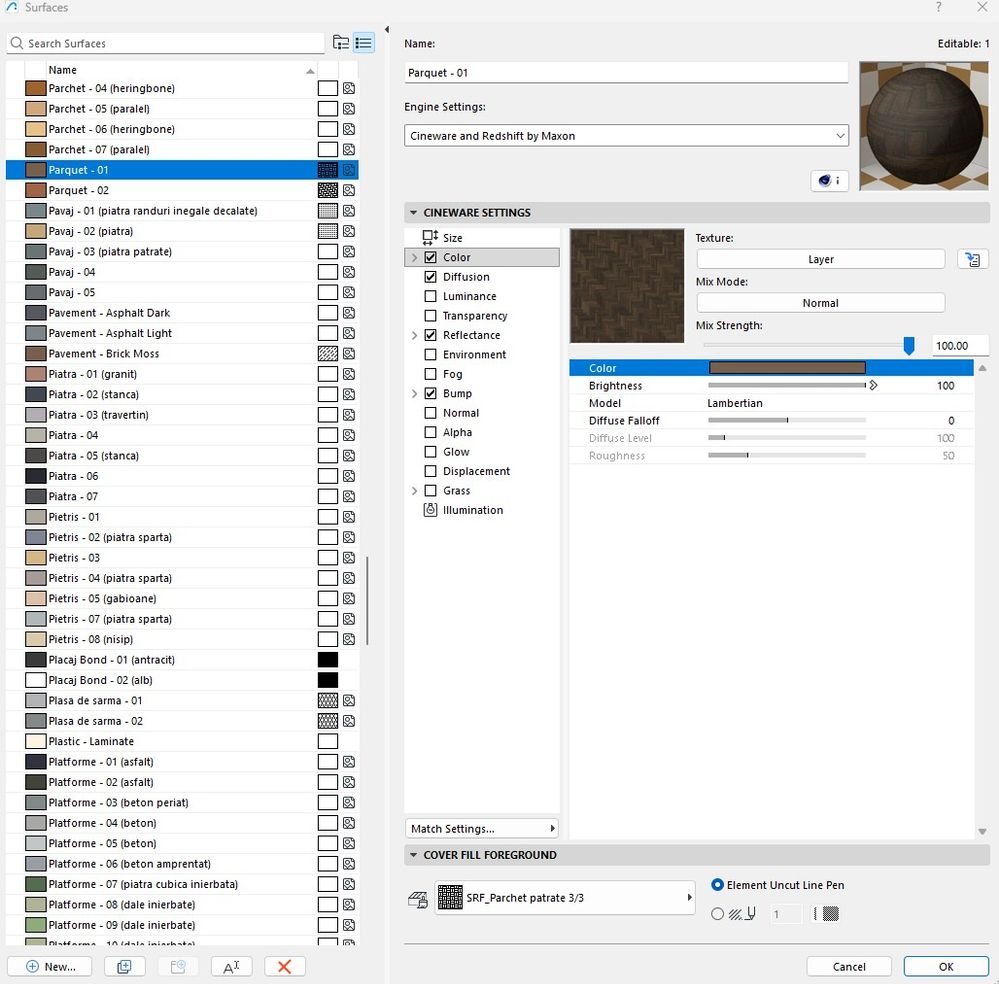

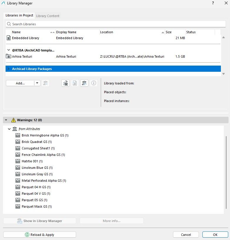

Library Manager is showing a warning about several missing attributes. They appear to be image textures, but I can't determine where they are being used. The Show in Library Manager button is grayed out, and the More Info... button points to surfaces that don't actually use the missing textures.
I've also checked the Cineware and Redshift by Maxon engine, but I still can't find where these textures are referenced.
Does anyone know where else I should look or how I can identify what is using these missing textures?
Thank you.

Can you show the exact error messages in the Library Loading Report?

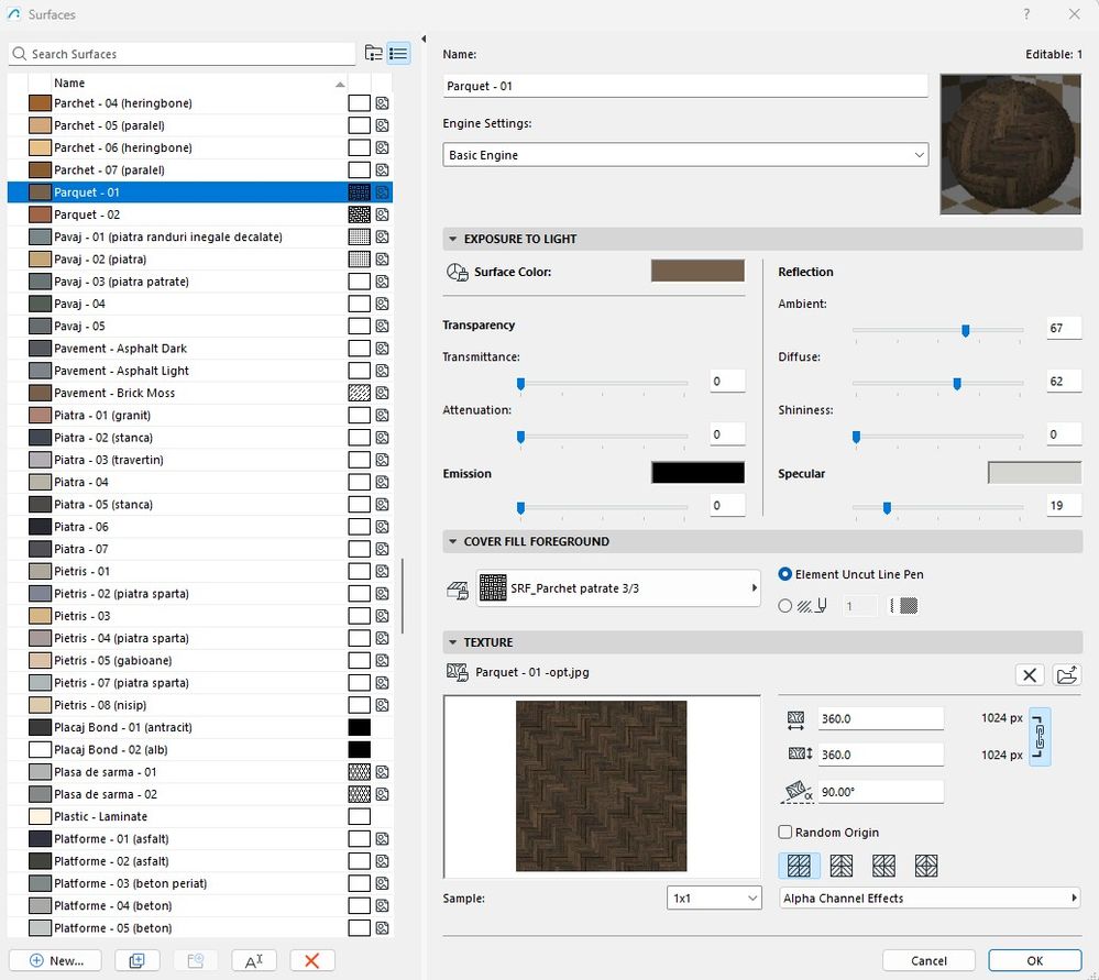

I have seen this type of issue before and I think it is usually some CineRender setting of a Surface where the image is used somewhere in one of the channels but sometimes it is very hard to find. In such a case, you can try to Update CineWare settings from the Basic Engine and that might make it go away.
Titiriga
Hello Laszlo,

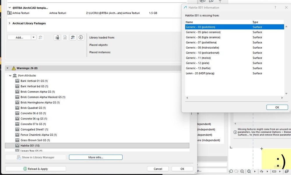

My process was as follows. After loading the new Library Packs and using the Favorite Converter Tool, I manually updated the favorites that were missed by the tool (mostly objects from older libraries). After that, I still had the missing attributes warning, so I went through the Surface list alongside a new out-of-the-box Archicad 29 template and copied the textures used there.
This resolved most of the 100+ warnings, but I'm still left with a few that I can't figure out. I've attached a few images showing my current situation.
Thank you.
