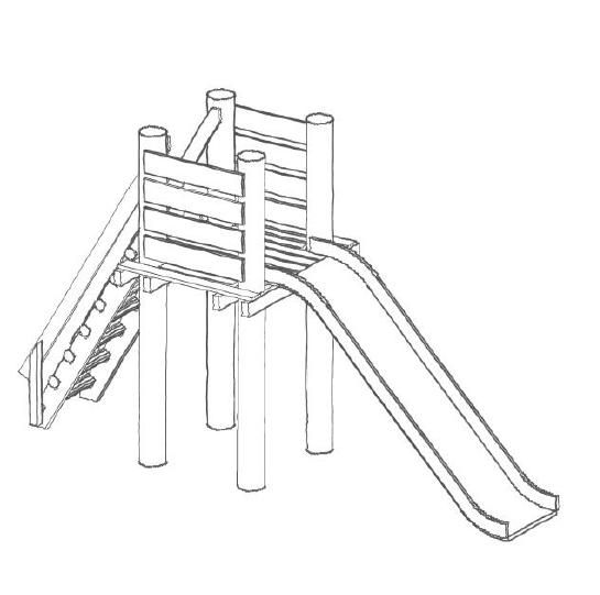

I am trying to create a curved playground slide. (see attached)
I found the attached object that has a slide like I am thinking about. I am not versed in GDL and do not know how to open the object and extract or learn how to make a similar slide.
What basic objects could I use to construct such a slide?

josh,
The fastest way to make the slide is to make two
complex profiles. One for the slide and one for
the side rails of the slide.
Or make two TrussMaker objects.
