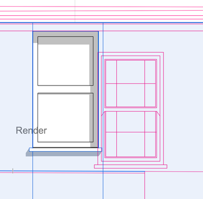

Wha't's the best window to use to create a vertical sliding sash window? I'm trying to draw something like the one shown in pink on the right. The window on the left is as close as I've managed so far which isn't great. I can't seem to find a window that slides open vertically. Thanks in advance for any help.

There should be a symmetrical vertical sliding window.
For asymmetrical windows we fake it by having a 0 height transom in between.

Standard Window object? With the opening type set to Single Hung? Sash set to Editable Grid?
Please state which version of AC you are using such as mine and Erwin's signature, as objects may vary between versions. See links in mine.
