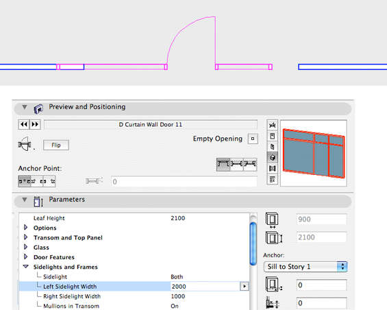

Curtain Wall Door 2D Symbol Bug
Setting different sidelight widths causes the 2D symbol to offset from the opening. The 3D view is correct. This occurs in both single and double curtain wall doors.
