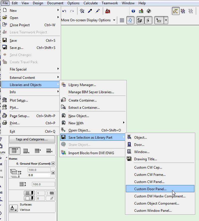

working in v17 & a custom door panel which i made with the slab tool isn't showing up in the pop-up menu within the Custom Panel leaf type.
I followed the instructions in the menu, & made sure that the library is loaded (no choice, seeing as i can only save it in the Embedded Library of the file). still, nothing shows up in the "Custom Panel Name" option.
i'm guessing this is very similar to this earlier query:

I'm going to ask the obvious (sorry).
Are you sure you saved it as a 'Custom door panel' and not a 'Custom CW panel' or something else?

"Door Leaf" it says in my menu. & that's the object setting i saved it into. Don't know why it says "Leaf" in mine & "Panel" in yours.
PC/MAC?
in any case, still no joy after re-saving it for the nth time.

Looks to me like you are using a Work Environment imported from an old version of Archicad.
Just noticed I am actually using a WE I set up for 16 so maybe yours is older than that still.
I know these save as library part commands did change but can't remember if it was 14, 15 or 16.
Try loading the default "Standard Profile 17" WE and see if that makes a difference.
You will need to update your custom WE if that is the case.

Interesting - I still see "Custom Door Panel" when i load the default 17 WE.
This is my first day using a new machine so maybe I don't have something set up properly but it is odd we are both seeing different menus in the default WE.
The reason I see "Custom Door panel" and you see "Door Leaf" is to do with the default libraries we have loaded.
I have a completely custom library and you may be using the default Archicad library.
The custom panel is created from a macro that is loaded in you library.
When I load the default Archicad library I see "Door Leaf" too.
So it looks like you are doing everything corectly.
Not sure if I can help any more (not that I have been much help so far) but what door object are you using"
If I get time tonight I will try to load it (if it is in the default library) and see what happens.
