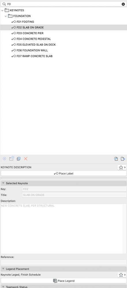

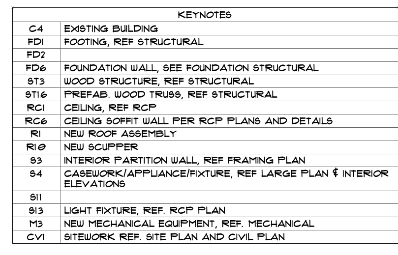

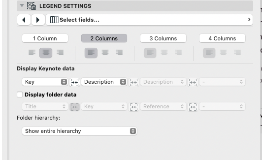

I am having a description line showing blank in my Keynotes.  I have placed a keynote on several drawings and the keynote legend is to show all in drawings.  However, the keynote ID is in the schedule and the description cell is empty.  I have made sure there were no extra spaces, retyped it and checked the legend settings.  On the image there are two lines missing.

Found out that once you change a keynote you must refresh the drawing the keynote is in to get the schedule to update.

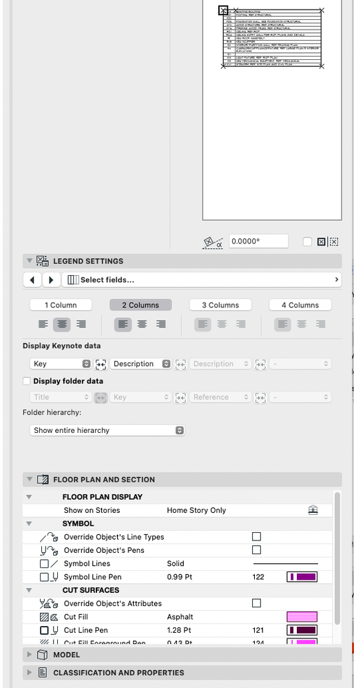

Done a Send & Receive? Tried Reserving All? Just to isolate that it is or is not some weird interation with TW?
GARY ACTON
Lingwisyer
Guru
Since the Keynote Legend is an Object, opening it and clicking OK to close it would probably get it to updated.
