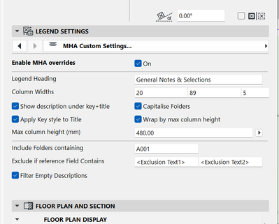

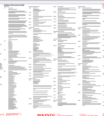

Hi Keynote users.
I've modified the inbuilt GDL legend object to have the format described above and a max height setting.
Is there someone on the Graphisoft development team I can pass the worked example on to?
I had to try out a few different methods to ensure the redraw was quick. I'll likely add in a set of presets for our office using a drop-down menu to ensure consistency.
The object preserves the original tool but allows for our office overrides with alternative subroutines. I have limited programming experience, but it seems to do what we want.
