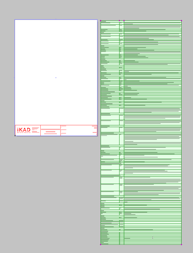

Hi everyone,
Does anyone know the best way to split a keynote legend so it can be printed across several A4 pages to form a standalone keynote document? I’m trying to extract the legend from a drawing and lay it out over multiple sheets rather than keeping it on a single sheet.
Any suggestions or workflows that work well would be much appreciated.
Thanks in advance.
AC-10 to 28 forward
Apple IOS
1 Reply 1
Patrick M
you could place it to a worksheet, then crop the drawing to only include the part(s) you need on each layout...
