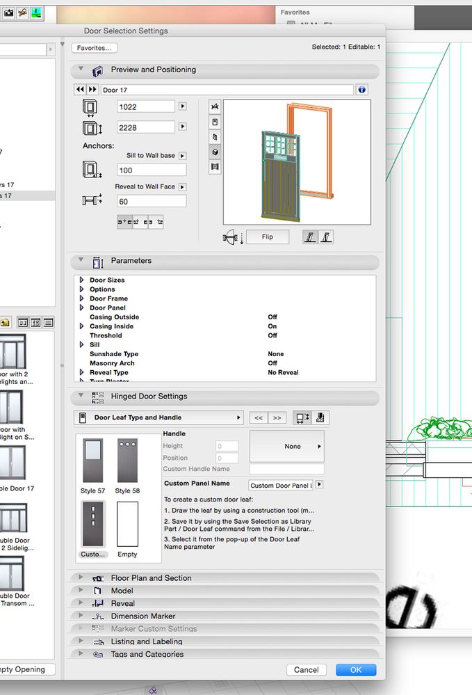

Right, what have I done wrong here? I don't make custom door panels often, so have I just clicked something wrong?
My door panel appears a couple of meters behind the door frame??
Something to do with how I've made it perhaps?
Any help appreciated!

Check this page that talks about this topic:
http://helpcenter.graphisoft.com/guides/gdl-guide-for-archicad-18/chapter-12-miscellaneous/doors-and...
Maybe the Slab or other element from which you saved the custom panel was modeled far from the X-Y plane and this causes this situation.
