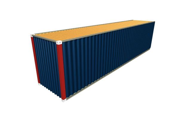

Sorry braza, no news today, I have been creating a zone section label, on which I had my mind for a long time. Now finally someone asked about it, so i decided to create it. You can see the result here.
I am making progress though on the sea container, but I only reserve a hours or so per day to work on it, please be patient.
No prob Master Script. Take your time.
Because the container is build up with different components, each has its own specific needs, I build these elements first.
This is what it looks like when put together.
I already understand it can be high-polygon object, so I create detaillevel controls.
btw, don't mind the colors
Its getting better!

At first I did copy and paste, but only to get the right dimensions, these feet and inches are killing me
I will use only the code of this macro, but only the parts I need. The container only has straight walls.

I am sort of doing that, but the problem is that the 2D drawing is inaccurate. At first I did the resizing, but then I noticed that sections and elevations did not align properly. Also 2 lines never intersect in a corner.
I first have to draw the lines according to the dimension, which is set in feet. So I have to set the working units to feet and inches. Then when I save an object I would rather have millimeter, so I set it back.
