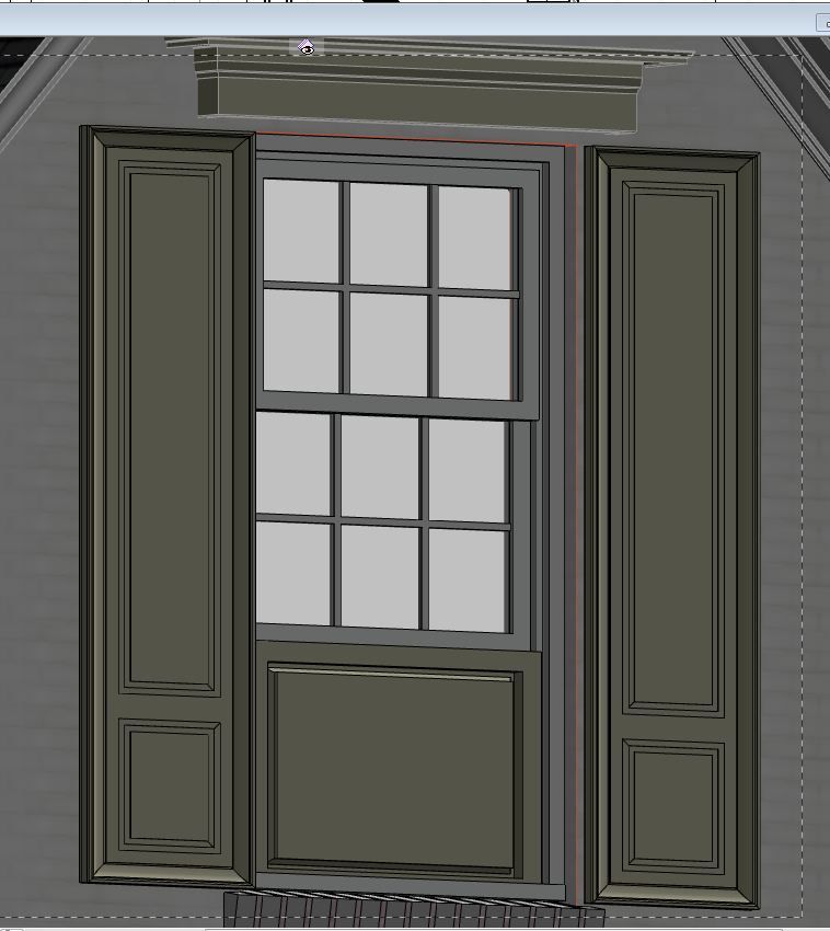

I need help to fix this error on GDl script.
Thanks

Error must be sought not in this element Sally Shutter Panel. Probably in the calling object in the calling object - Paneling EMK 12
Open macroobject and see what's in the script on line 3d
And in general is there a parameter with this name RAIL_BOT in the macro.
The script is generated automatically - Archicad. But maybe in version 12, and you are running 17. Could theoretically related with a version

giuseppe,
I scripted the part that is being called, but line 132 is an ENDIF statement and would not throw this error. The part Paneling EMK 12 must have been altered in some way. Take a look at what occurs at line 132 in your copy, that may expose the issue. Check in the parameter table to make sure that the parameter was not deleted. If that does not work post your copy for exploration.

Hi! I didn't modify the script of the part, I am using with other parts to create a window shadow. I am using 4 of your panels + one archicad trim.

giuseppe,
Can you post the composite part along with the called objects?

Can I upload the full object?
This is the object.

giuseppe,
I would try remaking the object.
I am getting the same errors as you, but there is not a discernible reason for them unless it is some error that occurred when ArchiCAD created the part. The lines and parameters that show up in the error message are all correct in the called part and error checking the called part does not yield any issues at all.
Ages ago I wrote a nail object for 2D detailing that included a moveable hotspot to switch from a schematic view to a "real" view of the nail. I could never get the switch to work until I created a new part, copied the exact same code into a text editor and then into the new part and reserved. At that point everything worked as expected. Sometimes weird errors creep in.

Thanks for your help, I already try to remake the object but I get the same result. I will try today in an other way and in a different version of archicad, will see and I let you know. I don't know much about GDL.
Thanks
No, good luck. the same result.
