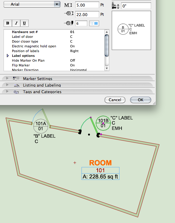

This topic is in response to the problem of having to manually merge Room ID and Door ID columns in schedules, when the door is supposed to automatically take advantage of the Zone it belongs to.
Example: we have 4 doors in zone number 101, labeled A, B, C, D. On the schedule, we want to see doors 101A, 101B, 101C and 101D, in one column.
Here's how you can do it by creating a custom marker. As an extra, we will add one more parameter that you can also include in your schedule. In our case, let's make it a hardware set number.
We will modify the Door Marker_NCS 16.gsm -- if you don't know how to find it, search how to extract ArchiCAD library to a folder.
TO MERGE ROOM ID AND DOOR ID INTO ONE PARAMETER, MOVE THE 2D SCRIPT SECTION SHOWN BELOW TO THE MASTER SCRIPT
!!--- Show ID ---!!!!--- Show ID ---!!!--- Show ID ---!!
room_num=""
If glob_context<>5 and glob_context<>1 and (GS_CustomText=`Room & Door ID` or GS_CustomText=`Room ID`) Then
(... AND SO FORTH, INCLUDING THE LINES BELOW:)
pen AC_TextPen_1
If GS_CustomText<>`Custom Text` Then
	Room_ID=room_num
	Door_ID=AC_WIDO_ID
Else
	Room_ID=GS_RoomCustom
	Door_ID=GS_DoorCustom
EndIf
THEN ADD THE FOLLOWING PARAMETERS
drID (type of variable: Text)
hdw_set (type of variable: Text)
ADD THE FOLLOWING LINE TO THE END OF THE MASTER SCRIPT
drID=Room_ID+Door_ID
REPLACE THE FOLLWING 2D SCRIPT SECTION
	if GS_CustomText=`Room ID` then
		style mtext11style
		text2 0,0,Room_ID
	else
		style mtext11style
		text2 0,0,Room_ID
		style mtext12style
		text2 0,0,Door_ID
	endif
WITH THE FOLLOWING (OR simply substitute the two variables)
		style mtext11style
		text2 0,0,Room_ID
	else
		style mtext11style
		text2 0,0,drID
		style mtext12style
		text2 0,0,hdw_set
	endif
IN THE PARAMETER SCRIPT ADD THE FOLLOWING LINE
values "drID" Room_ID+Door_ID
Save your modified marker, for demonstration i included the word "TEST" at the end of the name.
NOW, THIS IS HOW YOU ADD THE PARAMETERS FROM YOUR CUSTOM MARKER TO ANY OF YOUR LISTS/SCHEDULES:
  • Assign your custom marker to the doors in your project. Place the zones . Make sure that the doors can use the adjacent zone number, and then give each door individual manual IDs: A, B, C, and so forth (really, this can be anything you want)
  • Open "NCS Door and Frame Sch" and click the Scheme Settings button
  • Open the "Fields / NCS Door and Frame Sch" section and click the little black arrow next to the big Add button at the bottom. Choose "Add Object Parameters"
  • From the "Select Object By" drop-down select "Search criteria", Find names which "contain" "TEST" (Since I added the word "TEST" to the name of my marker, that's how I find it).
  • Select your custom marker from the results, and all the Available Parameters will be listed for you below. In the list on your left, locate your custom-added drID and hdw_set. Click the >>Add>> button to add them both to the list on your right (they showed up blue in my case).
  • Click OK when you're done.
  • You can now see your custom variables/parameters on the Available Parameters list so you can include them as columns in your schedule.
The rest should be pretty much self-explanatory. The door marker will let you use ANY ArchiCAD door with ANY custom parameters you want to add to the marker, and if you script it, you may show them in the marker or next to it. Use your imagination.
