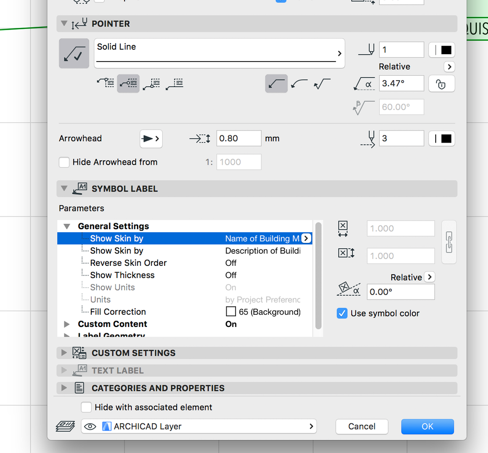

Very new to this GDL world but i wanted to do something that seemed very simple, but i am stuck.
I am trying to create a customized "Skin List Label" that could show me the following information: ID of Building Material - Name of Building Material and Description of Building Material.
I thought it could be easy since the script already has the possibility of listing all of this info. The problem is that i need to show all this info in the same Label. Currently the default label can only show one of these fields at a time.
I have just managed to see the new field within the dialog box, but haven't been able to show it in the actual label. See the attached images.

Bumping this topic, I would also like to know how to show both the ID and Name of a building material.
