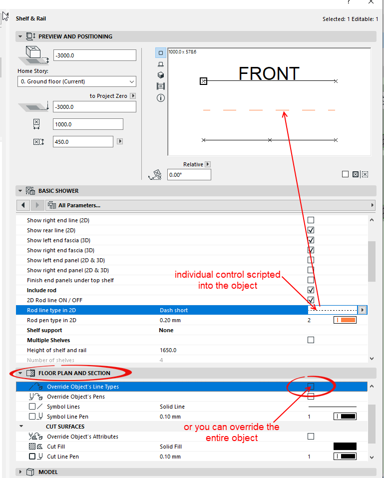

‎2024-02-06 03:10 AM - edited ‎2024-02-06 03:11 AM
If you want to control individual lines in an object, then the line type control needs to be scripted into the object.
Otherwise you can override the line type in the 'Floor Plan and Section' settings for the object, but it will affect the entire object.

‎2024-02-06 03:40 AM - edited ‎2024-02-06 03:47 AM
Hi Barry. Sorry, I should have been more explicit. I am looking to control the cut line type in Section, not Plan.

‎2024-02-06 04:10 AM
Sorry I should have read better.
There is no cut line type for objects in sections.
Cut lines are generated from the 3D model and you can only have solid lines in 3D.
If you ever see a dashed line in an object in 3D, it is a trick.
A series of short solid lines with spaces in between which has to be scripted in the object.
The only way I think you can control it is with a graphic override.
