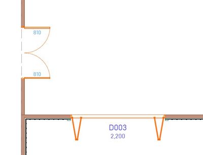

I'm currently creating a template as a project with specific parameters. My CI External Doors will have a specific door marker. My CI Internal Doors will not have a marker, but just show the door leaf size. (See pic)
I know how to create the door marker and show the leave size. However, after I have put in my External Doors with the marker in, it automatically sets my CI Internal Doors with the same marker.
Is there any way to differentiate in a template the different rules I want for External and Internal Doors?
Thanks in advance for any help
1 Reply 1
Patrick M
in the favorites pallete, you can right click and edit any favorite. Turn the markers off for the doors you dont want via that pellet
