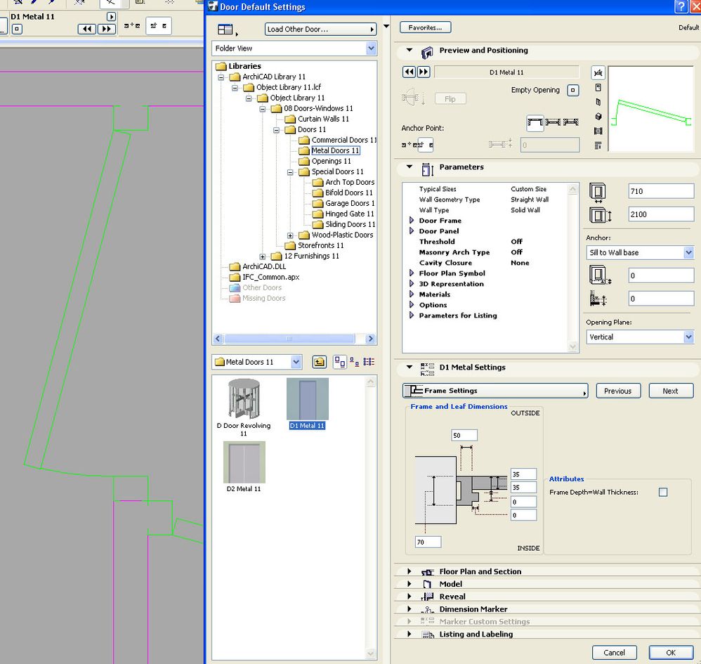

The way I have D1 metal door set up I can’t seem to get the wall line to show continuously where the door frame intersects it. (See image)
Any ideas how to get this done?

settings attached

I don't know if it's a coincidence, but it appears that the frame lines disappear when associated with an adjacent wall intersection. Perhaps the intersection cleanup is working against you. Have you tried moving the doors away from the intersections?
