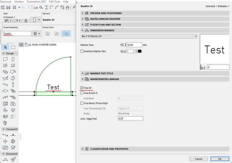

I have a project in AC24, where I have a problem with my Door Markers that do not show correct values for Element IDs.
I have changed my IDs in a door schedule and I thought everything was OK, but then I've noticed that all my doors still show the old, unchanged ID.
Has anyone else come across something similar? The Marker I'm using is a standard marker from our localized Archicad.

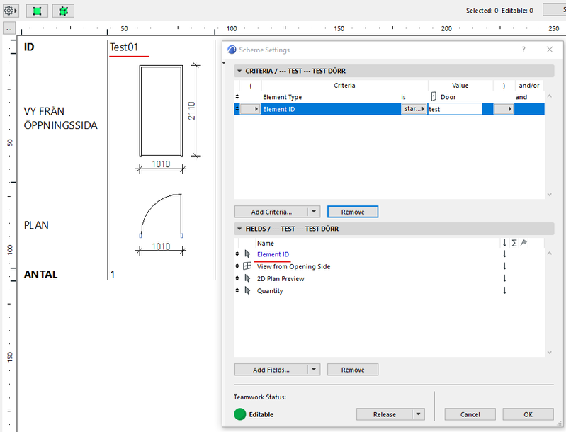

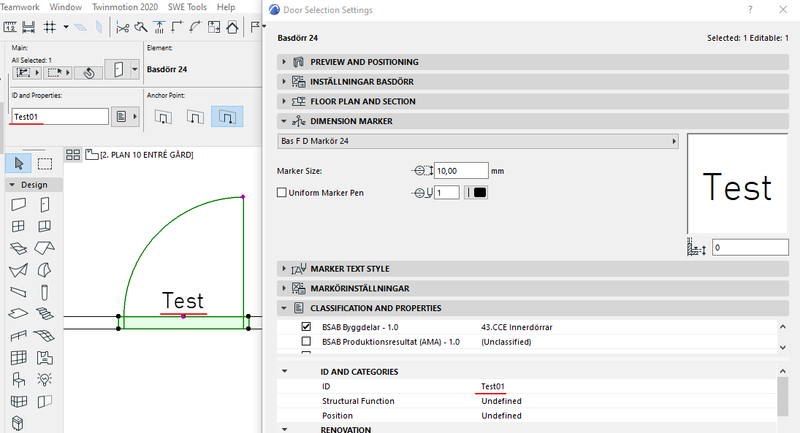

Here in my screenshot, I've created a new test door, named it "Test" and then in a Schedule renamed it to "Test01".
The ID parameter in the Door Settings is showing correctly, but the Marker shows the old ID. It only updates when I select the door in a plan view and do some change to the settings - for example change its fire rating.

For it to update, simply select all the doors in 3D, edit and ok, no need to modify a parameter.

Yes, I've tested it on an empty default AC Template in AC24 and the bug was there too, not only in my file. Fortunately it seems to be fixed in later versions, or at least in AC27 that I tested.
I think I'll go with labels then, that seems safer. Otherwise it could potentially be an expensive mistake if someone forgot to "update" all doors before the project is submitted.
