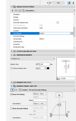

Hello,
I'm trying to add the fire resistance rating of a door to the floor plan. I am well aware that one option is through a separate label, but that's inconvenient.

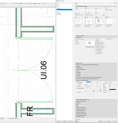

I've setup the Fire resistance rating of the specific door in the Door settings dialogue and in the properties, as shown below, through MVO but nothing shows up on the actual floor plan other than FR (fire resistance) as if the Measured Value = 0.
Does anyone have a solution for this?
Thanks!

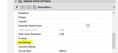

The problem is that your door value is referencing a different value than the one you set-up. The one you have "rezistenta la foc" is not the Fire Resistance rating that the door references, that's a custom property made by the ROtemplate. The one you're looking for, where you can add the door FR that will show up on plan can be found on the last page of the door setting.
