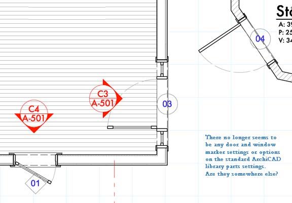

I have immersed myself in version 14 recently and came across an apparent missing part of the standard doors and windows. Using the basic ArchiCAD 14 library (which I verified is current), I can't find any way to alter the markers. The Marker Settings isn't there, and what you see on the attachment is all I can do. No controls whatsoever. Am I missing something?

If I understand you right, you might look in Document>Set Model View (MVO).
Is attached what your looking for?
Scott Newland
Thank you for the reply. I accessed Model View Options via the View pull-down, and made sure the doors and windows were shown with markers. They were. Still, the markers may be there but they are not the markers I like and there is no apparent way of changing them. Under none of the window settings parameters are there any marker controls.

Scott:
Your door dialog box is missing the Marker Settings panel, to turn it on, go to Work Environment > Tool Schemes > Tool Settings Dialog Boxes, select the Door Tool and make the Dimension Marker visible. You should save this change to your Work Environment by selecting the Tool Schemes in the left panel, selecting the appropriate Stored Scheme on the right, and clicking the Redefine button.

YES!!! I was completely unaware of this tool command option. I selected the appropriate marker options, saved the scheme, and they now appear under the settings for the windows and doors. Thank you very much for this help!
