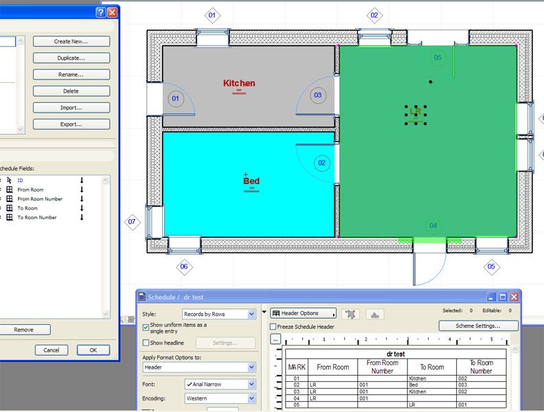

Screen shots demonstrating what is not working along with settings would save everyone a lot of time 🙂
1. In the attached, the schedule reads correctly most of the time as Kevin says despite having checked the setting to read zone from where the marker is placed. I suspect this is the problem you are having?
2. The geometry option of other than the circle for the door is grayed out because circles are the NCS standard for door markers.
3. post a screen shot of what you want your marker graphic to be and also what you want your schedule to show.
In the attached screen shot I want
-both doors 04 and 05 should read LR as the zone.
- Doors 01 and 03 should both read Kitchen
- door 02 Bed
this screens hot shows results with door marker_NCS 14

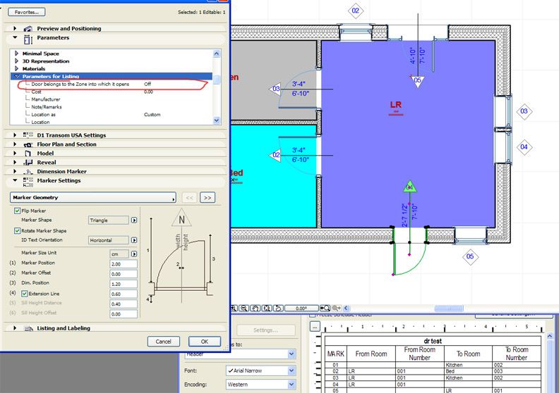

This shot shows Door Marker 14
I can choose the shape of the Marker,
It has an obscure setting under Parameters for listing letting you have it not belong to the zone is opens, but this still does not give the desired result
