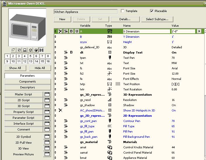

Hello Everyone
I am trying to place sub-directory into Microwave Owen SE9 parameters, Dishwasher and Fridge have a subdirectory called "DISPLAY TEXT", so I want do have same thing in Microwave Owen.
Thanks
undefined
1 REPLY 1
David Maudlin
Rockstar
dmoraca:
In addition to replicating the parameters from the Dishwasher part (as it appears you have done), you also need to copy the "*** 2D TEXT ***" script portion from the 2D Script of the Dishwasher into the 2D Script of your Microwave Oven object. Some code debugging may then be necessary to get the text to work as you desire.
HTH
David
