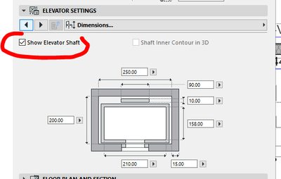

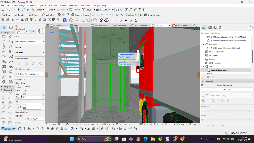

How do I set a custom lift height on the lift shaft? I can't change it in general or the shaft settings.
Setup info provided by author

In order to access the shaft sub-menu, you have to "enable" it from the dimension settings page:
Afterwards, regarding the heights, you can opt to edit them from the slab and overrun settings, the shaft will follow accordingly.
hope this helps.
