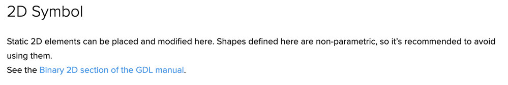

In my 2D-only object, I've utilized almost all 16 layers, in an effort to make the object as versatile as possible. And with your suggestion, I made them toggle-able with parameters. Now, I'm wondering if I could introduce some very basic parametric elements, beyond just "on/off" for the FRAGMENTS. My current object is all 2D elements to represent a millwork section, and I'd like to make the countertop depth parametric, as one example. However, I found this snippet in the GDL center; is this accurate?

The fragments are not parametric, just static images.
So they are good if you just want option A or B or C.
To have a truly parametric symbol, you will need to actually script the detail with GDL commands (lines, rectangles, polygons) using parameters to control the sizes.
