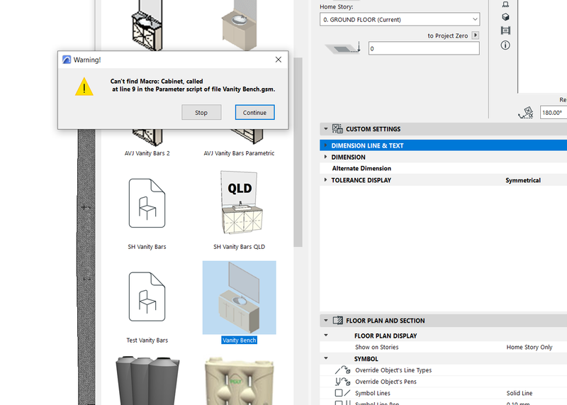

I separated this object from a lcf file but i haven't obviously brought across the macro (I'm guessing macro is another object which together with other macros makes up the object) so how can i find the exact obj or file name of the macro missing
4 Replies 4
Yes, a macro is another object that is CALLed into the main object.
The one you are looking for is called "cabinet" and should be in the same LCF as the original.
scottybaustralia1990
Perfect thanks for that!
