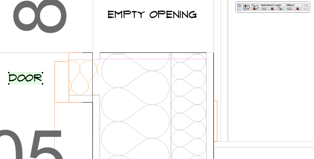

I want to put an empty door opening in a wall but it wont close the wall with the plaster finish.
Ive posted an image that shows the opening with a purple line where I would like to see the plaster finish. What setting do i need to put on the empty opening for this plaster finish to show on the plan?

Hi, yes I should have stated that I did use the library openings
For any empty opening wether using a library part or empty opening, how do I show the plaster finish on the reveal??

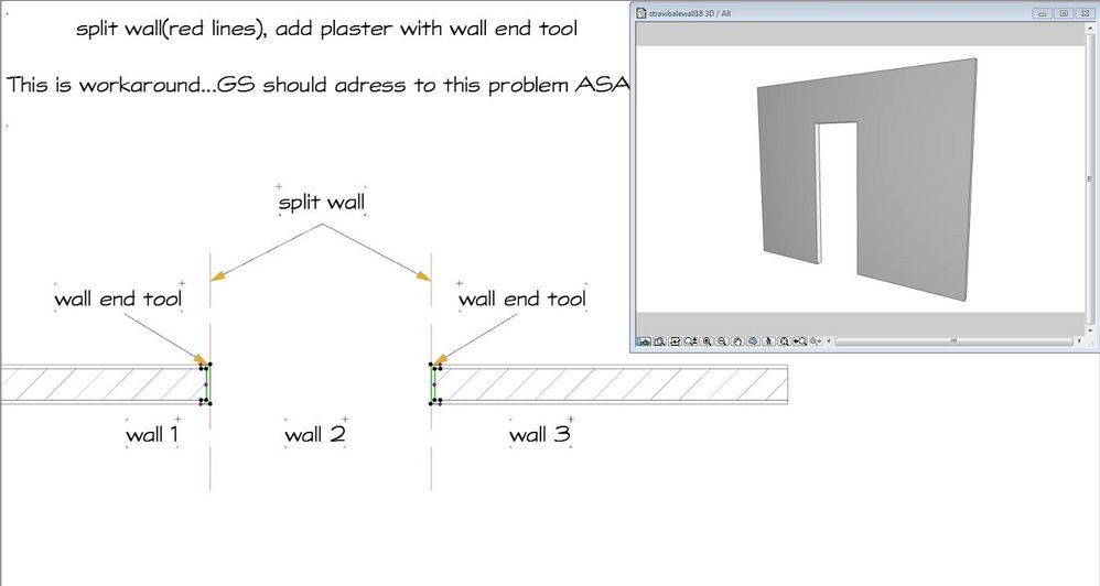

I was surfing on www waves and see your problem...Let me help you...
This is workaround...I don't know what problems this workaround could bring...so....be careful
Insert door - empty opening, split wall, add wall end tool.

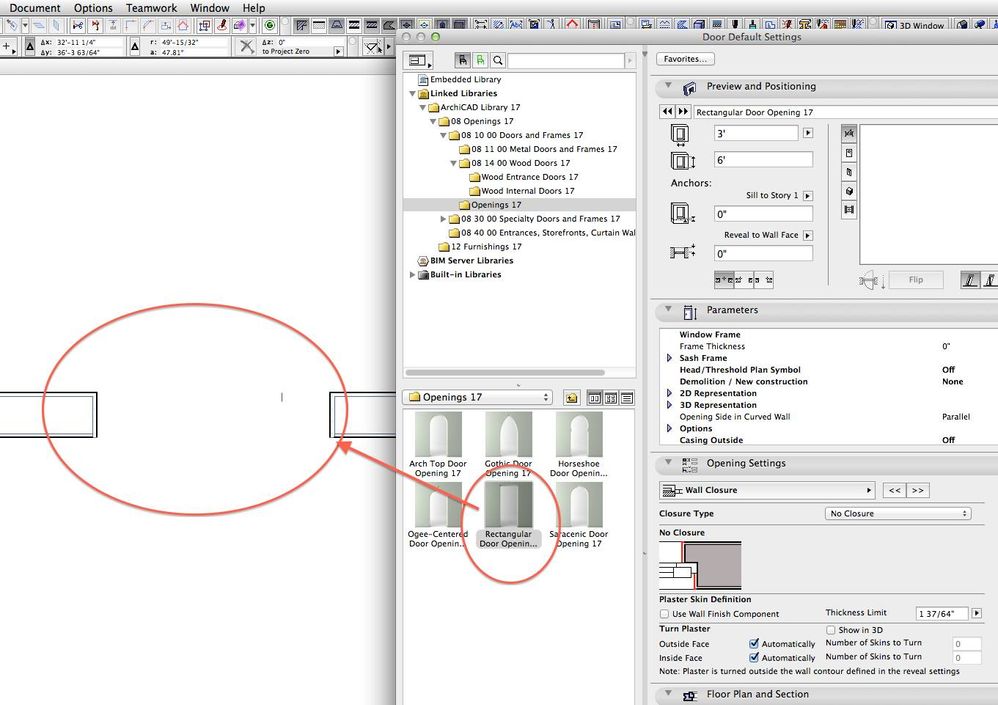

Have you tried the library part under "Openings" called "Rectangular Door Opening"? It provides for skin wrapping. See attached screenshot.
If this part is not in your international library, search for it in the search field of the Door Settings dialog... it is available for download from there if you do not have it.
