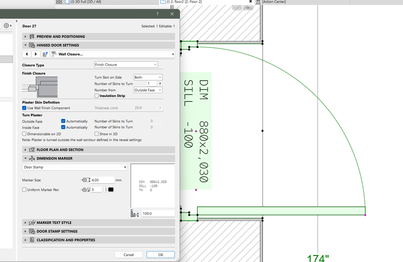

I’m working in Archicad 28 and facing an issue with composite wall finishes at door openings.
Problem:
In a composite wall, I want the plaster finish to continue behind the door frame, but currently the plaster stops at the wall face and does not wrap behind the frame.
I am using:
  • Composite wall with plaster as the outer skin
  • Hinged Door (standard Archicad door)
  • Closure Type: Finish Closure
  • Wall Closure settings enabled in the Door Tool
Setup info provided by author
3 Replies 3

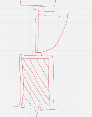

The model looks correct. Maybe you can share a picture of what you want?
bimerbioboi
please have a look at how the plaster behaves with respect to the door frame, this is what i want
runxel
Uhh.... I don't think that any of the GS doors allow this; I've tried but didn't manage to accomplish this.
But on the other hand to have the plaster done like this is also highly unusually.
