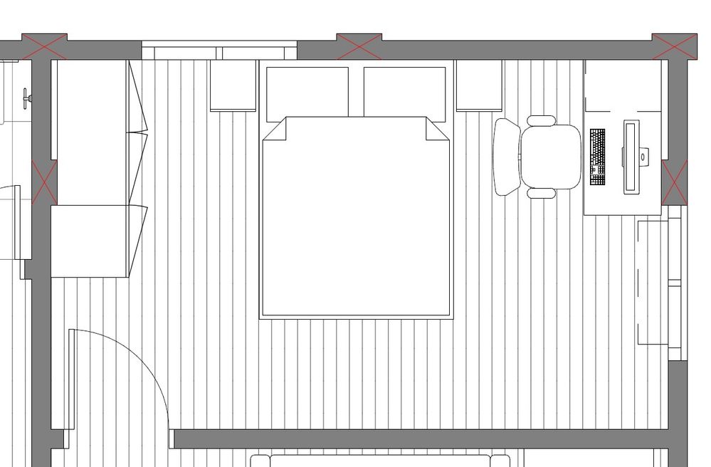

How to hide overhead objects in archicad? Even when above cut plane it shows. For example, a wardrobe placed overhead overlaps the one below. If I send to back, the lines just thickens and it is not really hidden.
Solved! Go to Solution.
3 weeks ago
Unless the object is specifically scripted to, which the default cabinet objects are not, objects will not respond to the Floor Plan Cut Plane. So your option is to hide the ones above in some way. This could be via a seperate Layer, or a Design Option, or but using a unified object so that the top cabinets are part of the same object as the bottom ones.

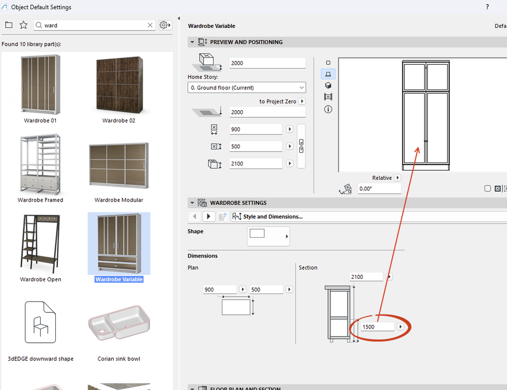

What about the variable wardrobe and adjust the bottom section height and the handle heights.
3 weeks ago

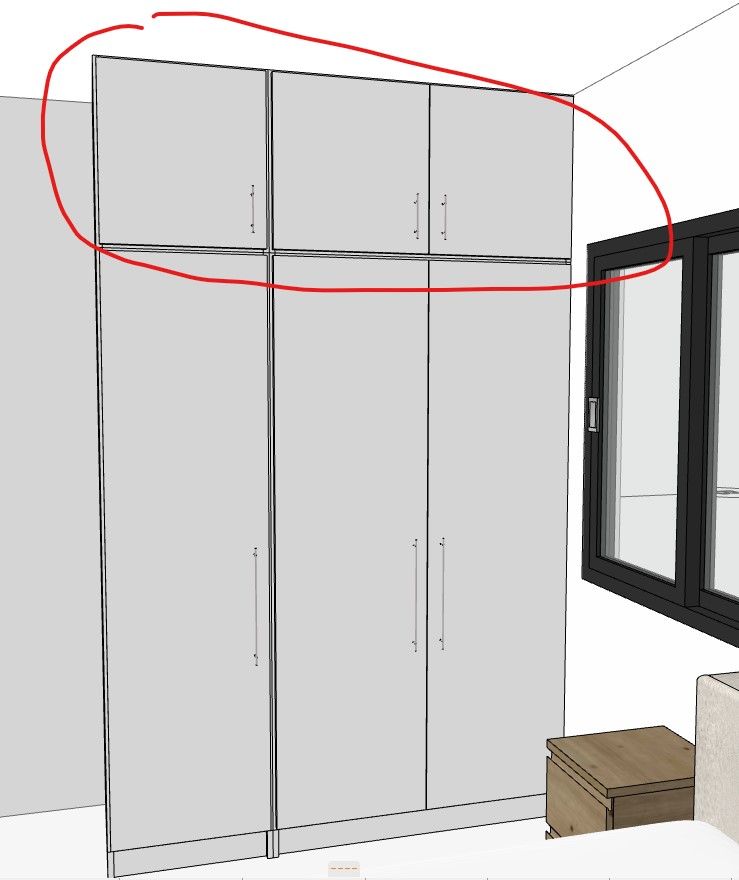

Hello, I tried this one. I can make the carcass as per the configuration inteded, although i cant seem to raise the door handle higher for the lower doors. Maybe im missing something.
3 weeks ago
Seems to be a bug in the object.
The lower handle height is constrained - I don't know why.
But, the taller the lower door is, the lower the handle has to be.
Looks like someone got their math calculations mixed up.
Without saving a copy of the object and then editing the script, I don't know any way to change it.
Except turn the handles off and add your own.
3 weeks ago

The constraint is from the shorter door height. It has a range set from 20 to min(doorHeight[1], doorHeight[2]). *facepalm* Who ever wrote the object seems to like using the min command instead of using the actual provided values...
ps. If you care to edit the object yourself, you just need to change the following at line 397 of the Parameter Script:
doorHeight=min (doorHeight[1], doorHeight[2])
to
doorHeight=doorHeight[2]
The top door does no appear to use this parameter.
