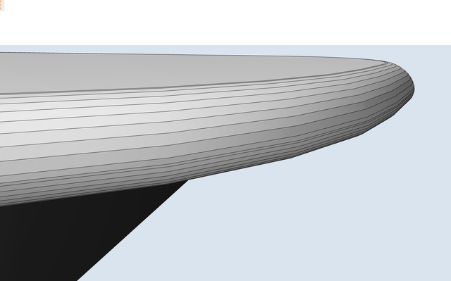

Hi all,
I cannot find or work out the status code that will hide the contour lines of the curved hill on an FPRISM_.
The FPRISM_ is the perfect gdl to make the shape of furniture, but it keeps coming through with lined contours. I know I could just make it from a morph but I would love to be able to put in parameters for this kind of table top in future.
If anyone can let me know what I am missing it would be very much appreciated. I am making this in Archicad 25.
I have the tabletop script below.

FPRISM_ surf_Tab, surf_Tab, surf_Tab, surf_Tab,
NSP/3, 0.035, 0, 0.035,
USE (NSP)
MULZ -1
NSP/3, 0.015, 0, 0.015,
GET (NSP)
DEL 1
ENDIF

HPRISM will give you an extra status control that will allow you to control the visibility of the hill edges.
FPRISM does not have that control.

Thanks Barry.
I totally missed HPRISM_
But why does FPRISM_ still exist?
Graphisoft Certified Archicad BIM Manager - AC6 to AC25/AC26 macOS Ventura
Legacy.
If it was removed, any existing objects using it will stop working.
