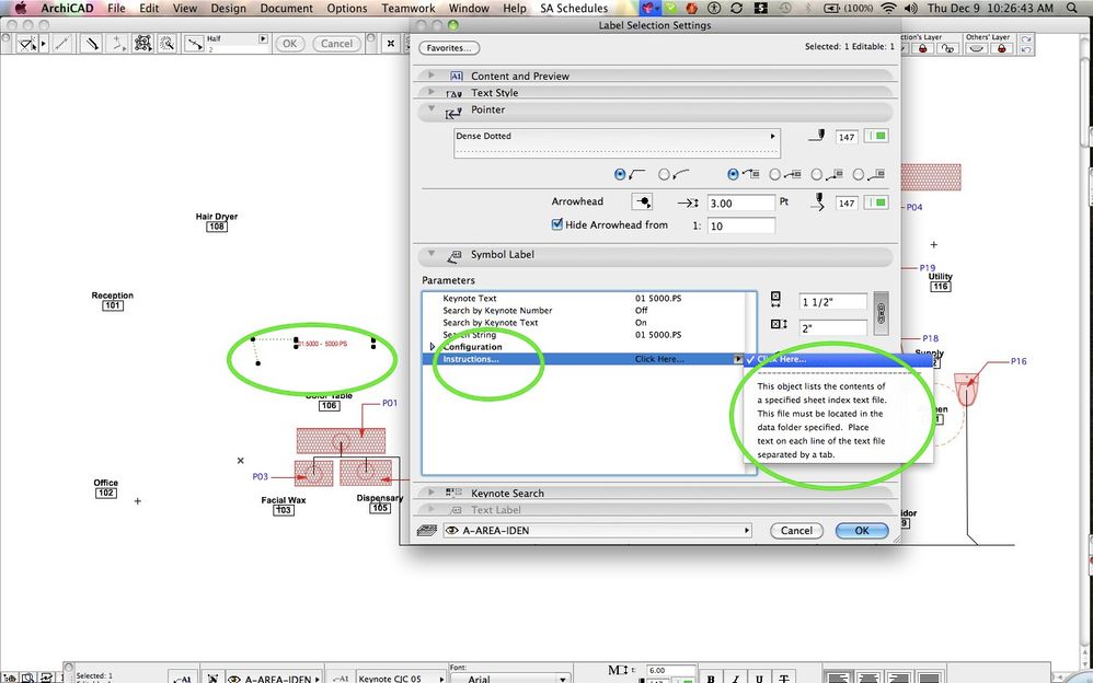

Tim wrote:
.......the attached label object I have written, which reads a text file and sounds like may help you parsing numbers out of the text data. All of our keynote data is stored as text strings however, but numerical strings should be convertible to real numbers using the SPLIT() function. If you look in the parameter script you will find the code that reads the text file..........

Karl wrote:I believe the Cadimage keynote tool can do this.
The thing that I have heard many people wanting still seems impossible though - the ability to place a list of keynotes on each layout sheet which ONLY contains the keynotes used on that same sheet. (I suspect that Graphisoft would have to implement that kind of feature, as I do not believe that even the API gives 3rd parties what they need to dig into the views for each placed drawing on a sheet...?)
