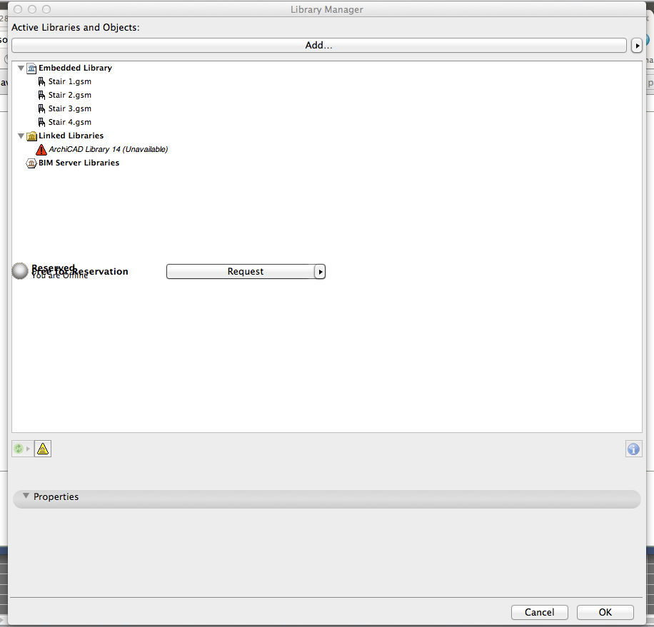

I am trying to attach 2 screenshots before and after loading the libraries. Perhaps I am doing something wrong? I've refreshed the element list from here. I also previously tried embedding the folder contents into the file.

Here's a screenshot after I load the library. Objects are still missing at this point, and I am not sure what to do next.

The migration library is not a full library ... it is intended to be used WITH the AC 15 library. Load the AC 15 library and most (all?) of those 14 objects should be automatically converted to 15.

I never really figured out what the problem was...so, maybe it was the file. I found another saved version of the file that is opening with all the objects. I'm glad I saved multiple versions.
