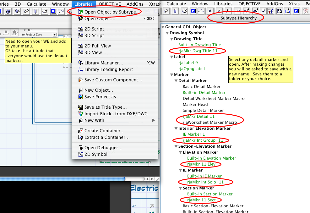

Archi wrote:
Where are Markers saved in AC?
When you get 11 you will need to set up your WE with access to a menu called "Open Object by Subtype".
There you can access all markers to set your defaults.
See attached for additional info.
Rod Jurich

I have AC 10.
It is nice file structure for AC 11. Very nice.
