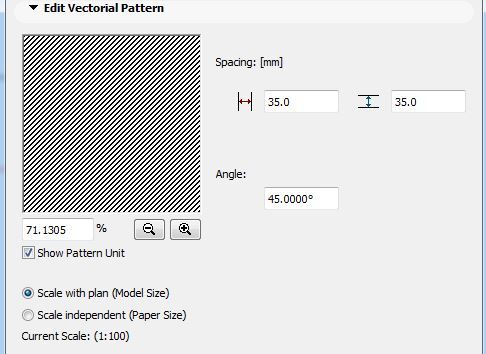

Just worked out how to define a fill in GDL and choose between 'Scale with plan' or 'Scale independent', as per the standard Fill Types Options - using the FILLTYPES_MASK when defining the fill.

but there is a j4: scale independent.
If you set the fill type to: fill_types = j1 + 2*j2 + 4*j3 + 8*j4 then you can control the Scale with plan / Scale independent option.
Hope this helps someone.

If I understand correctly, this is an undocumented feature, in which case I need to inform GS to include it in the Docs.
I am also wondering if this has changed in AC17 since there is a new Fill Category: "Cut Fill - Building Material". I don't know now if this is considered different from the "Cut Fill" category in GDL, I know it is different in the ArchiCAD UI.
In any case, I let GS know about this and they will update the Docs.
