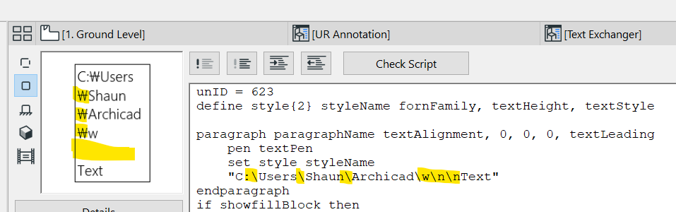

How long has GDL had Regex functionality in Texts or Textblocks?
I don't think I ever noticed it before.
Is there a way to ask GDL to ignore the Regex language?
Cheers,
Shaun.

‎2023-05-24 06:42 AM
Yep looks like it is the double, I just googled backslash for Regex and I believe the convention is "\\". I think "\t" is used for the Text I/O Addon.
Cheers,
Shaun.

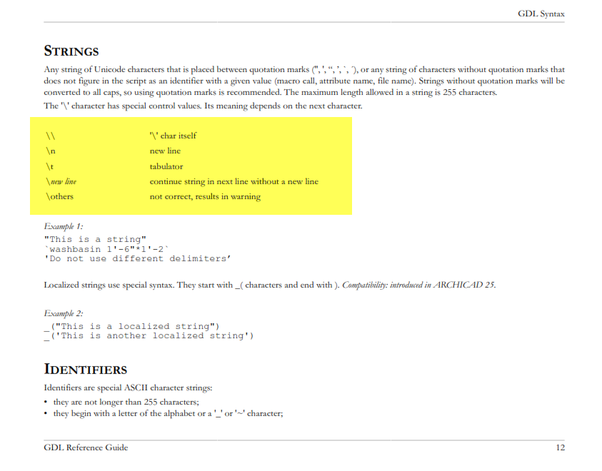

‎2023-05-24 06:45 AM
I think \t is tab space.
\n is carriage (line) return.

‎2023-05-24 06:49 AM
Yes, that is correct and is the convention for Regex (Regular Expressions). I thought I would ask about it. I wonder if GS has documented all the possible expressions that can be used in GDL?

‎2023-05-24 06:53 AM - edited ‎2023-05-24 06:53 AM
Yep, page 12 of the GDL reference guide.
