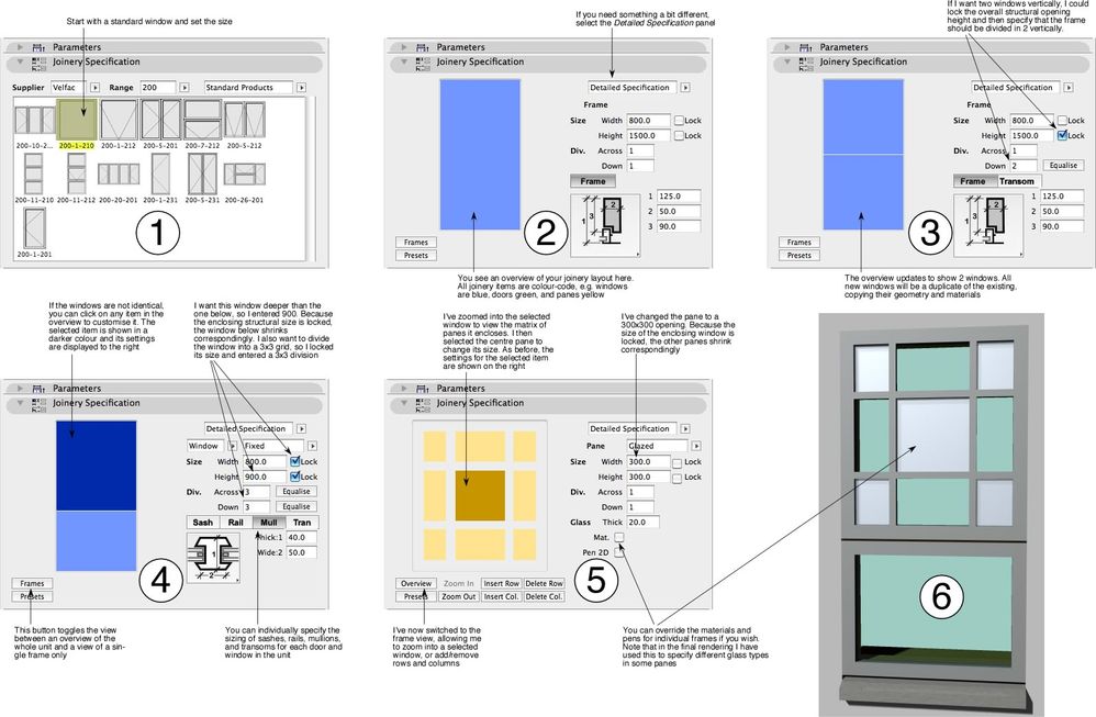

Steven wrote:
I got the MJO and was spitting excitement to try it out. Then, I opened the window preference box and couldn't figure it out, it all looks greek to me (sorry to anyone from Greece...).
I just want a <b>[censored]</b> double hung mulled window!!!
Did you have a quick look through the manual? This object has a number of unique characteristics, so it's worth having an overview of how it works. I've attached an example that might reflect what you're trying to do:
  • 1. First view the Standard Products panel to see if there is an off-the-shelf configuration that suits your purposes. If that's all you need, set the opening size and you're done
    2. If you need want something tailored to your specifications, move to the Detailed Specification panel. This displays an overview of the joinery unit, with the specification for the selected item to the right. You can select a specific item by clicking on it in the illustration. All items are colour-coded according to type, and change to a darker colour when selected
    3. In your case, you might want 2 windows vertically, so you might lock the structural opening height and specify that it should be divided in 2 vertically. Note that the illustration changes to reflect this. The new window will be an exact copy of the one you started with. If that's all you need, you're done
    4. If you want even more detail, you can select individual windows to specify their opening size, type (left/right/top hung etc), and sash/rail/mullion/transom sizing. In this case I've made the top window deeper. Because the structural opening is locked, the lower window has become correspondingly shorter. I then locked the window size and specified that it should be divided into a 3x3 grid. If this is all you need, you're done.
    5. If you want yet more detail, you can toggle the Overview into a more detailed Frames view. You can then zoom into a specific window to view and specify the configuration of panes within it. In this case, I've selected the middle pane and changed it to a 300x300 opening. Because the bounding window size is locked, the other panes shrink correspondingly. You can also override the default glazing material and/or pens for individual panes, which I've used in this example to make a pattern of different coloured glazing.
    6. The finished result in 3D
There's a lot more, but this should get you started. Take a look through the manual to discover more.
Ralph Wessel BArch
Central Innovation
