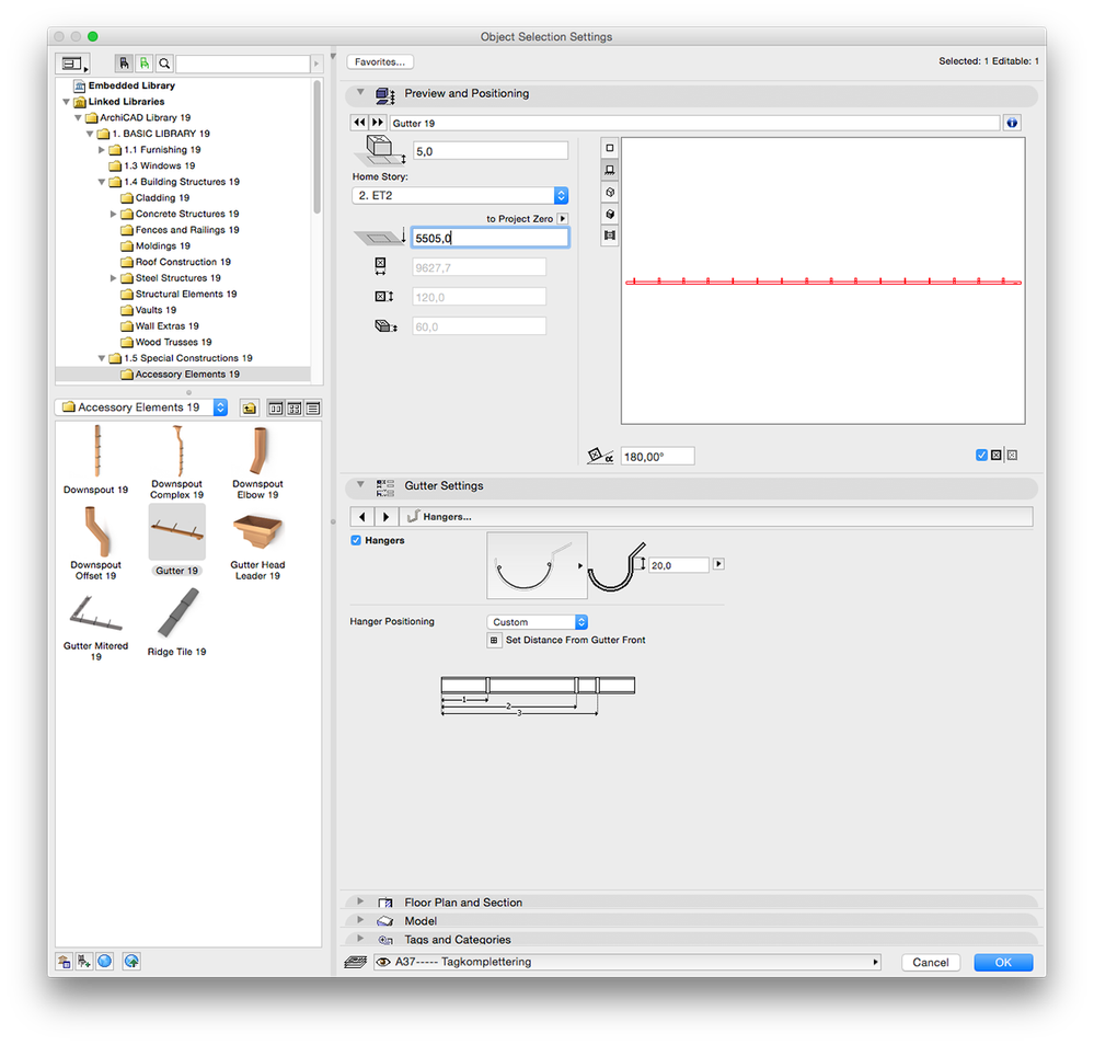

I cannot find the hanger angle adjustment option in the new object settings. I used to be able to adjust the hangers to the sloping angle of the roof. Is this parameter gone in AC19 or do i need to open the object GDL and make the adjustment there? If so, how do I do that ?

I've reported this to local reseller and they have reported it to Graphisoft.
Workaround for now: load ArchiCAD18 library along with 19 library, use the 18 object to set up the parameters, if you are done, you can remove the 18 library and it will automatically be replaced by the 19 part, but retain the settings you made.
There are a few more objects that are missing the UI interface to change parameters that are still part of objects.

Hi Erwin
Thank you very much for the answer and workaround. This was very helpful.
