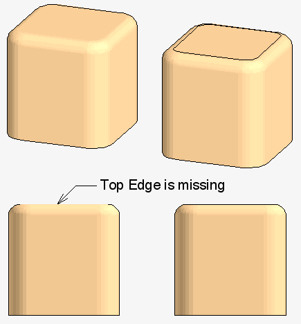

HPRISM_ & Top edge visibility
This is an old feature, which I always found annoying.
For the first solution (Left), top contour edges don't show in elevation.
Am I missing something?
Cheers
	R   = 0.2
	mat = SYMB_MAT
	for k = 1 to 2
		body -1
		s = 11 + 4*(k=2) + 64
		hprism_  mat, mat, mat, mat,
			10, 1, 0, R*0.5, 1,
			R  , 0  , s,
			1-R, 0  , s,
			1  , R  , s+1000,
			1  , 1-R, s,
			1-R, 1  , s+1000,
			R  , 1  , s,
			0  , 1-R, s+1000,
			0  , R  , s,
			R  , 0  , s+1000,
			R  , 0  ,-1
		addx 1.5
	next k
		del 2

No, you are not missing something. I always check with this code, because these status codes always confuse me

But I have a dirty fix for you:

I'm aware of these "global_context" workarounds. I'm not satified with them.
In case of object rotation (x, y, z), it can't be a solution.
I still have to add a parameter to control (manually) the mask value, in function of the rotation, which is not predictable.
I would like a fix, not a workaround.
There is always the solution to deal with GDL primitives (vert, edge, pgon). What a pain.
It defeats the purpose of this tool.

Sorry, I don't think so. My status code just means 11+64 (first) , and 15+64 (second).

I don't follow you.
	for k = 1 to 2
		print s
	next k
It returns 75 and 79. All is fine.
My remark was about status code 11+64 (75). I don't want 15+64 (79).
64*j7 controls the viewpoint dependent visibility of the current vertical edge.
I was wondering about a similar feature for the horizontal top edge visibility.
