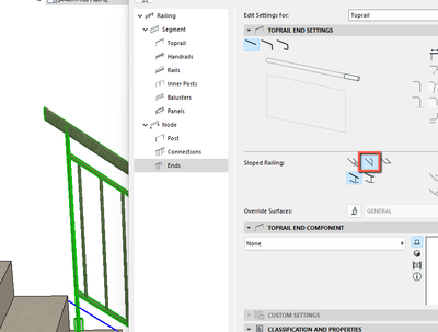

Hello!
I have a problem with the handrail angle in my railing. I would like the handrail to end in the same angle as the railing itself, but I can't get it to end not in a 90° angle to the axis.
I am guessing this is a tiny hook somewhere in the menus (hopefully), but I am going a little insane because I can't find it.
Could anyone point me in the right direction? Because I am getting to the point of thinking about using beams to finish this thing and I would really like to avoid that.
Thank you for any help!

Gortz
Is it this one maybe?

Perfect! I feel so silly, but I was only looking inside the handrail and general settings. It worked 🙂
